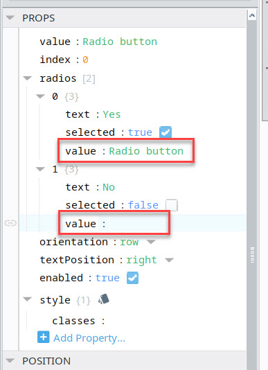

I believe I experienced a similar issue and thought I’d share what worked for me in case it can help you.
For the radio button, it would seem one needs to ensure the values are set to something not just the defaults.
Defaults:
Once I changed values to what I wanted to pass to db the script began working as intended.
The script in my scenario was triggered by a button as shown here:
I’m sure this is not the most efficient way of doing this but it worked.
