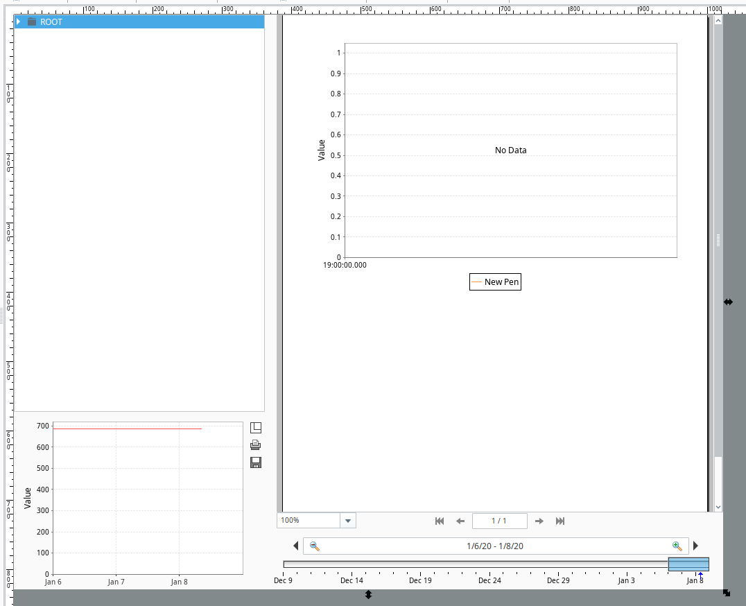

Is there a way to do with but use a Tag Browse tree to pick the tags. Maybe a Easy Chart to drop the tag on, and Date Range to pick when the report is gets the data. I was going to use vision to do this. So that I can add it to new projects and give the operator a way to dynamic make a report with whatever tags and whatever time range.
Something like this:
See @paul-griffith’s responses. Use a script data source. Customize the JFreeChart to manually generate your desired pens from the scripted data. To pass the pen list, I would construct a dictionary in Vision with the details, and serialize as json to a string parameter of the report. The script data source would deserialize that and perform the necessary history queries.
Doable, but decidely non-trivial.
