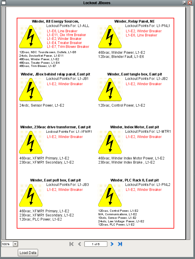

I attached a screenshot and window and as you can see I am very close to finishing. I started with your scripting and concatenated the lockoutpoints and prevented duplicates. I ended up with a dataset with all of the needed information in each row without need a detail record. With this I was able to use the label shape and make all labels the same size.

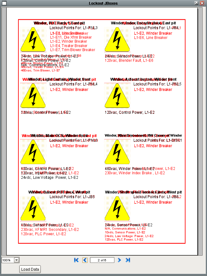

I do have a question about the formatting. I am trying to place a red border around each label. If I use the “stroke” then I get a single border around the whole page even though in the designer it shows a border around each label.
If I use the “shadow” with an offset of zero then strange things happen. It appears that once the text is written to the screen it doesn’t get refreshed.
Is this another case of me not using the software right?
Lockout_LabelReport_Sample.fwin (55.9 KB)
Not sure about your shadow problem, but the border is easy to solve - you’ve got the stroke on the entire label container, not the individual label. Notice when the prototype label box has the light red highlight when you’re applying the stroke.
Thank you! I was not selecting the individual label as you pointed out. The shadow issue no longer applies.
Here is an example of the final product. I say example because I have several different layouts with different sized labels.
Once again, Thank you for all of your help.
