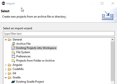

I did figure it out...I didn't import the example project correctly. I deleted the project from the Eclipse work space and imported it as a Gradle project and voila, all the dependencies are detected and import are resolved. I should rename this post.

Incorrect
Correct
