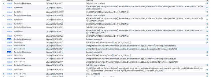

Has anyone got ignition to work with the new S7-1200 Generation 2s
I know they are supposed to be closer to a 1500 then a 1200 but neither option appears to work on symbolic
I’ve had no luck so far when trying to use symbolic addressing so wondering if anyone else has got this to work?

What sort of logs are you getting with the Siemens loggers set to Debug?

No worries please find the logs below
Detailed breakdown on the connection errors

Thanks! The logs suggest that the library we use is unable to detect the PLC type. We're trying to get our hands on one to test internally, but assuming your PLC and device connection are configured appropriately, there is probably nothing you can change on your end to get symbolic access working.
I’ve used the same setup as the S7-1500 so I’m assuming it’s all correct.
