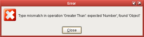

Which I have defined LineNum as an integer and simply put the number 4 … I can tie to that with another dynamic property and it returns a 4 however I now get the following error.

This worked … thought I should update the thread …if(toInt(tag("[ROC_5911001]T"+{RootContainer.System.LineNum}+"-01"))>134217727,100, if(toInt(tag("[ROC_5911001]T"+{RootContainer.System.LineNum}+"-01"))>67108863,90, if(toInt(tag("[ROC_5911001]T"+{RootContainer.System.LineNum}+"-01"))>4194303,80, if(toInt(tag("[ROC_5911001]T"+{RootContainer.System.LineNum}+"-01"))>1048575,100, if(toInt(tag("[ROC_5911001]T"+{RootContainer.System.LineNum}+"-01"))>524287,40, if(toInt(tag("[ROC_5911001]T"+{RootContainer.System.LineNum}+"-01"))>262143,61, if(toInt(tag("[ROC_5911001]T"+{RootContainer.System.LineNum}+"-01"))>131071,70, if(toInt(tag("[ROC_5911001]T"+{RootContainer.System.LineNum}+"-01"))>2047,60, if(toInt(tag("[ROC_5911001]T"+{RootContainer.System.LineNum}+"-01"))>511,50, if(toInt(tag("[ROC_5911001]T"+{RootContainer.System.LineNum}+"-01"))>63,51, if(toInt(tag("[ROC_5911001]T"+{RootContainer.System.LineNum}+"-01"))>31,100, if(toInt(tag("[ROC_5911001]T"+{RootContainer.System.LineNum}+"-01"))>15,30, if(toInt(tag("[ROC_5911001]T"+{RootContainer.System.LineNum}+"-01"))>7,20, if(toInt(tag("[ROC_5911001]T"+{RootContainer.System.LineNum}+"-01"))>3,40, if(toInt(tag("[ROC_5911001]T"+{RootContainer.System.LineNum}+"-01"))>1,11, if(toInt(tag("[ROC_5911001]T"+{RootContainer.System.LineNum}+"-01"))>0,10,0))))))))))))))))
Yeah, sorry I forgot to mention that you’d need to cast it.
