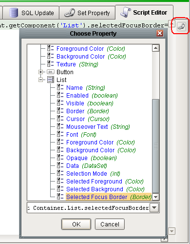

The easy way of getting to that property in the Jython editor is with the Insert Property Reference button, which looks like a chain link. It will let you browse down to the Selected Focus Border property of your list box directly. Then use the (=) assignment operator to set the border type.

Hes not actually setting a focus border, he’s requesting focus for the component so that his focus border shows up. But the insert property reference button is still a good tip - at least it’ll get you to the component properly.
