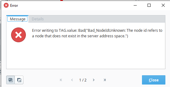

Beginner here new to the world of ignition. Currently taking the inductive university course and sad to say as the fast learner that I though I was, I’m stumped a few videos in.
I’ve created a boolean tag on TIA Portal,stored in the global memory, addresss %M2.6
Through the documentation, the tag editor should be configured as [PLC NAME]Mx2.6
But I’m returned with an error in configuration. What am I missing?
Is put/get active in the hardware config of your plc ?
try MX2.5 instead of Mx2.5
It is enabled.
Figured out it was cause i had " Activate UPC UA Connection" disabled!
enabling this allowed me to connect to the memory booleans!
i also have boolean addreses for Inputs and Outputs %I1.0 %Q2.0
but these arent getting picked up by ignition when ive got the tag path as [Siemens_1500]I1.0 or Q2.0
do these need additional synthax?
IX1.0 and QX2.0
Oh perfect!
Is there no default synthax that would always assume its a boolean? Like the documentation say I can IWO to determine an offset but without the “O” synthax, it doesnt look for an offset?
