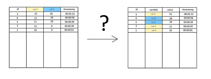

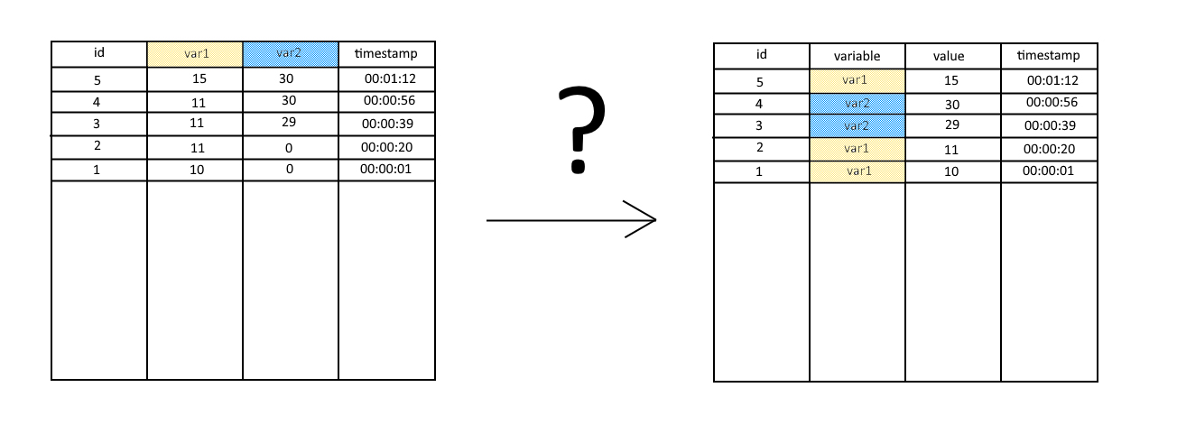

Is there a way to organize differently the columns and rows in Transaction Group?
I want the name of variables to be in rows, instead of columns.
Thanks in advance for your response!

Look in to block groups.
If it will always be one variable per row, just use the Tag Historian. That how it works.
Thanks for your response.
I haven’t precised, that I want to have a bi-directional communication, so Tag Historian won’t meet this assumption.
Block groups add rows with all variables, when one of them changes value. I am looking for a solution, where one row with one variable is added, when it changes value.

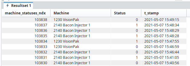

You are going to want to script your storage, then. A single project tag change script can do this. You would have it subscribed to all of the tags of interest.
On the block group just select the “insert changed rows” option and then only the row that changed will be inserted into the database table. Should give you exactly what you want.
Works as I wanted. Thanks Duffanator!
