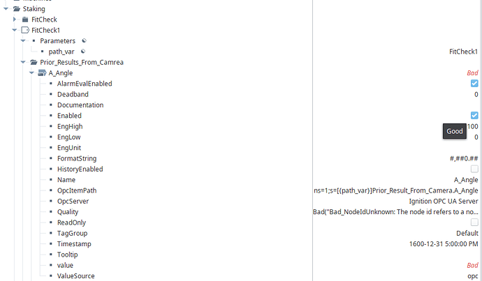

UDT Tags not populating with The correct Tag path based off paramter
I am having some issues with a UDT tag path. I created a tag path with a parameter but it is showing that the tag value is bad…

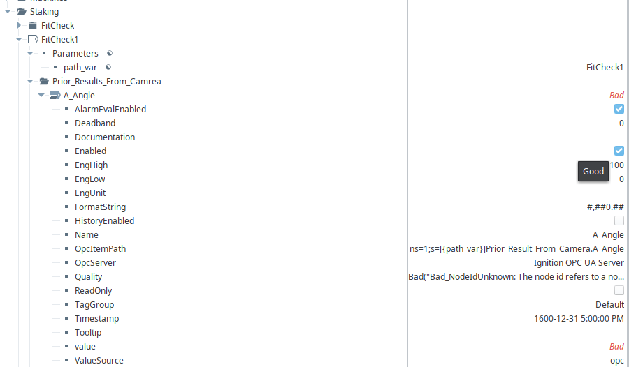

This is the OPC Item path: ns=1;s=[{path_var}]Prior_Result_From_Camera.A_Angle
This is the tag that I am using as an example. The “FitCheck1” is not populating where the path_var is in OPCItemPath. Any ideas?
See pictures below for reference.
Thanks!

Hi @ddidio, I can’t replicate the issue. What version are you using?
Apparently, it was a bug with the 8.1.3. We updated to 8.1.7 and it seems to be fixed.
