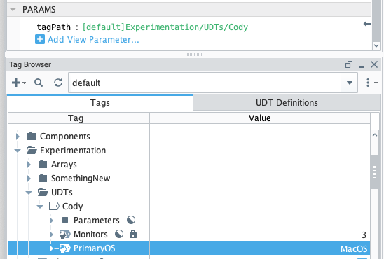

Now, in the Popup, you’ll want to set up bindings which use that incoming tag path. In the following screenshots, you’ll see that I have a UDT instance in place, and I’ve passed that value along (in theory) to a Popup.
Note here that I’ve supplied the path to the UDT instance - NOT the individual properties/values of the UDT:
Screen Shot 2021-09-11 at 10.02.19 AM
Now my binding will use that tagPath param, and while using an INDIRECT tag binding I can complete the path to the individual value of the UDT that I want to use (PrimaryOS):

Thanks, I know have this working using the tag path as described.
