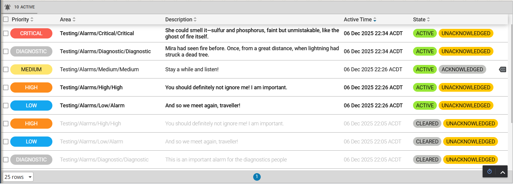

Alternative Alarm Status Table Styling - Use Pills for Priority and State columns
Disclaimer: I haven’t tested any of this all that thoroughly yet!
I had a request from a customer to change the alarm status table styles. This was a bit of fun (and headache).
This requires CSS and a bit of JS injection (required for the splitting of the State values).
It has a number of parts:
  1. Alarm Status Table component which contains specific rowStyles
    Alarm Status Table - Copy JSON and Paste into a Flex Container

  2. Markdown Javascript injector component which converts the State column text into separate components and adds them into a flex
    Markdown JS Injector (State-only mods) - Copy JSON and Paste into the View containing the AST

  3. CSS to add to the Advanced Stylesheet
    Stylesheet CSS to define the: alarm priority colours and the state pill styles

If you just want to import a single View, here’s the project export in 8.3.2. You’ll still need to copy in the styling into the adv. stylesheet though.
AlarmStatusTable-AlternateStyling.zip (44.2 KB)
They also wanted the datetime formatted differently as well, in case you want this too. If so, replace the Markdown above with this version:
Markdown JS Injector (State & Datetime mods) - Copy JSON and Paste into the View containing the AST
