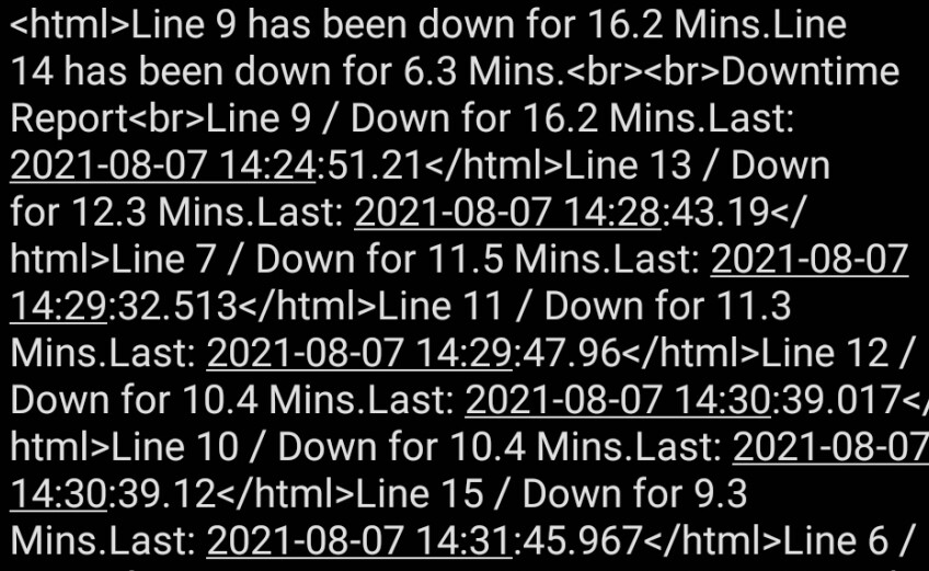

I have some VB apps using SMTP to send SMS text messages to my Verizon cellphone,
now I am using Ignition gateway scripts to do the same but I haven’t been able to add line breaks to create a multiline text so it can be easier to read, ex: I’d like to get in a string something like this:
when using
it doesn’t work for SMS… I just get one single line with my HTML characters included…
is there a way to add a line break without HTML?
I’ve done this using other software like VB and just added CrLf to my string to create a line break…
NOTE: Using HTML in my string works fine when sending the information to an email account… it just doesn’t work using verizon SMS… ##cellphonenumber##@vzwpix.com
any thoughts?..
