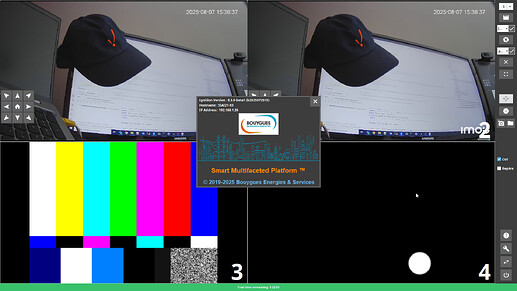

:new: VIDEO starter kit for Ignition Vision and Perspective 8.1 :video_camera: !
3 use case:
  1. A standalone video wall Ignition Vision project
  2. A video wall Ignition Vision Project with the choices of the cameras driven by an Ignition Perspective Project
  3. A video stream displayed in a standalone Ignition Perspective Project
    (3. is a tricky and complex solution. Don't use it in production without running test over time)
  • Ignition Vision edition support :
    • RTSP H264/H265 video stream (or video File, webcam, or Gstreamer test pattern).4K supported
    • ONVIF PTZ (Pan Tilt Zoom) commands to control camera PTZ if available. Command with:
      • mouse :computer_mouse
      • buttons
      • usb joystick :joystick: :video_game: (tested only on windows OS)
  • Ignition Perspective edition support :

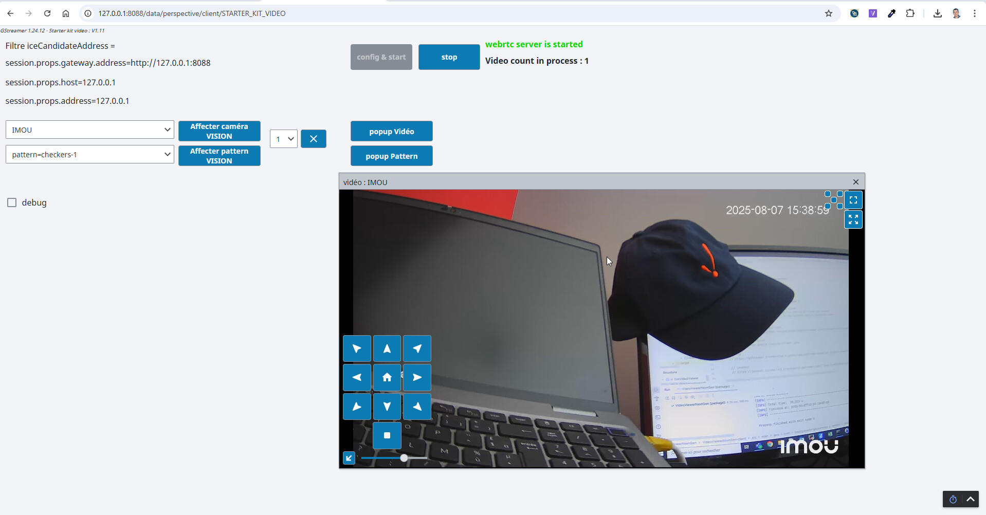

    • RTSP H264/H265 video stream encoded to WEBRTC H264/VP8/VP9 or Gstreamer test pattern
    • ONVIF PTZ (Pan Tilt Zoom) command to control camera PTZ if available. Command with:
      • buttons
h264_petit onvif_petit

Settings:
  • Adjust settings in: shared.commun.constantesCustom.PLATFORM
    • use of vision, perspective, a joystick or not
  • Adjust camera settings in: shared.commun.constantesCustom.VIDEO_SERVER
    • onvif endpoint and rtsp stream user/password
    • adjust the port serving the page of the iFrame with the webrtc client
      • adjust the maximum perspective session displaying video stream
Launch Ignition Vision and/or Perspective Project
For perspective : start the video server: with the button: "Config & Start"

Now available for Windows, Linux and macOS Sequoia
For Vision and Perspective
(tested under windows 10, 11, server 2019, 2022, ubuntu 24.04, adn macOS so
install gstreamer full version with good, bad and ugly plugin
:warning: on Linux, webrtc protocol used to stream the video for perspective require to install: :warning:
sudo apt install libnice10 gstreamer1.0-nice
Project example:
https://www.dropbox.com/scl/fi/rjcoasx3e86tb139y348b/STARTER_KIT_VIDEO_20241124125202-1.10.zip?rlkey=ksdk7ahagzvgr50qb59r03mbv&dl=0
Add images on the gateway (for vision):
https://www.dropbox.com/scl/fi/qvcb0jdr1r32ukwqwcm4n/images_starter_kit_video.zip?rlkey=ba2wm0l1k95a472lda872pe3h&dl=0
Use the module for vision and perspective:
https://www.dropbox.com/scl/fi/ksuaq8m7fig5378fic64f/BYES-VideoViewerNextGen-signed-1.8.28-LIGHT.modl?rlkey=eljkgghoma105lzmxnwteh36a&dl=0
or the module for Perspective only:
https://www.dropbox.com/scl/fi/4udfgi2yclirddm5f9yym/BYES-VideoViewerNextGen-gwonly-signed-1.8.28-LIGHT.modl?rlkey=s2rn1oa9qugdzd2pds2pst2o8&dl=0
No camera video at hand ? use one of the video test pattern generate by the module to check the video stream is send for the gateway to the perspective client, or to check the video is displayed in vision client.
:warning: for perspective, the video is streamed with webrtc. You can adjust the min/max rtp port range used by webrtc. Those TCP ports must not be blocked by your firewall :fire: on the gateway. (1 port is dedicated for each client with an active video stream)
Perspective
Vision

Video module in action with Perspective:
