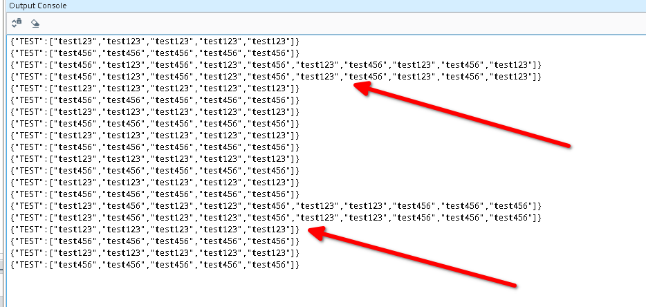

we have sometimes a problem with Webdev. If a request from 2 different applications to the same API, the results are sometimes wrong.

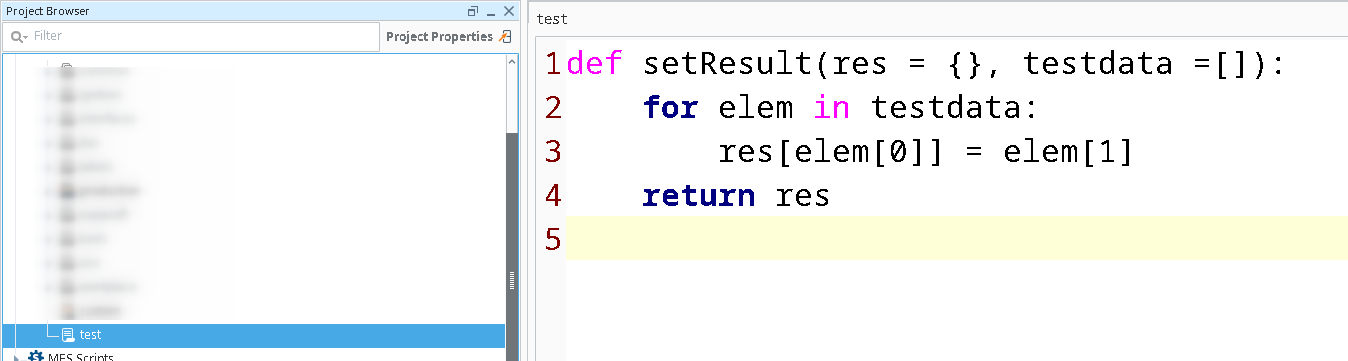

test.setResult Function :

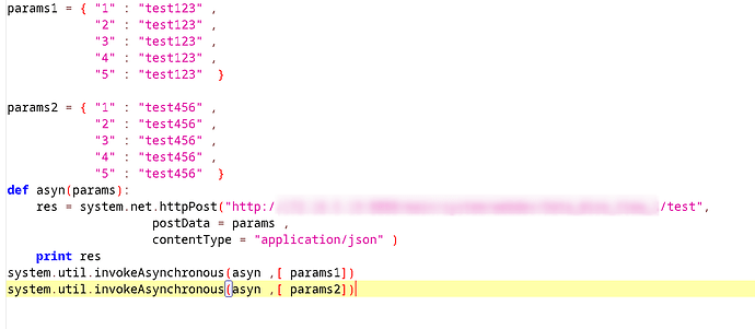

Now i call the the function remotly via script console, i do it 2 times with system.util.invokeAsynchronous
to simulate nearly a “call at same time”
the result in from print statement :
As you can see the Arrays are somtimes merged. This behaviour we are not expecting.
Is it a Bug?

I am pretty sure this
def setResult(res={}, testdata=[])
is the issue.
Try:
def setResult(res=None, testdata=None):
    if res is None:
        res={}
    if testdata is None:
        testdata=[]
    for elem in testdata:
        res[elem[0]] = elem[1]
    return res
Check this out - Do not use mutable objects as default arguments in Python | by Timur Bakibayev | Geek Culture | Medium
Typically it’s a bad idea to use a list, set, dictionary, as a default keyword argument value. Better off using None and then initializing if it is none.
For such an application, I would not use default arguments at all. Always pass both arguments.
