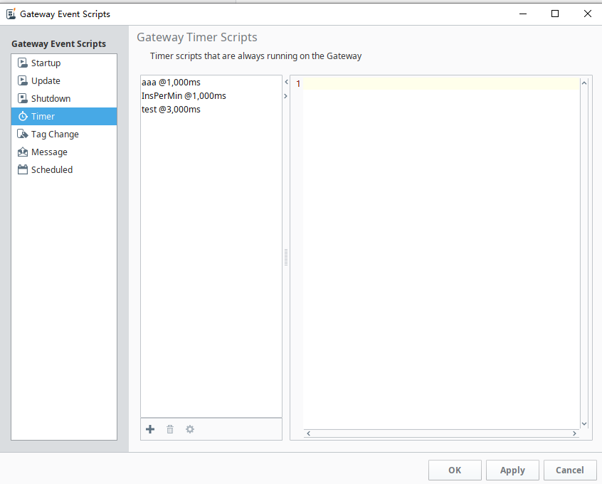

Which is the Necessary Module for gateway event Timer script
The problem is a bit of ridiculous.
We wanna minimize the number of the module for the purpose of being economical, these are what we have:
But we found that the gateway event timerscript fails to work out of no reason, especially the Gateway Scripts in Status display nothing:
while we do have some Time scripts configured:
Can Anybody Help me cause it almost piss me off.
Thank you guys, thank you so much.
There is no module required.
Are these scripts part of a runnable (not inheritable) project?
Yeah my colleague just solved it and he just created a project inherited from the original project. It is really out of my understanding :rofl: :rofl: :rofl: :rofl:
You need to be careful defining things like timer scripts (and transactions groups, and pipelines, and other “runnable” things…) in an inherited project. Every project that inherits from it will be running a copy of the timer script or “runnable” thing.
