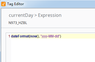

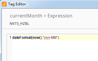

When a new expression tag has been created, I have to waiting for it long time every time and always can see a red color symbol of ‘!’ over there.
such as:

This works for me if you just want the current month. There is probably an error in your expression but you don’t show the whole thing.
thank you.The value of the expression is dataFormat(now(), “yyyy-mm”), After a few hours, it has a result but wrong.
As you see, the pattern part of the function should be written in capitals.
The expression is right now, but time is still a problem?

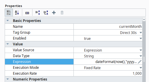

I’m not sure why it’s not updating quickly. I put the same expression in and it updates instantly. You have a tag group assigned but your execution rate is fixed, still shouldn’t be a problem. What do you see if you look in the tag diagnostics for one of the tags that has the error on it?
