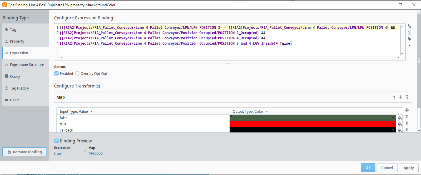

I have multiple tags in this label and based on the compare of 2 of this tags and at the same time if 2 other tags are true and 1 = false
it will go from true to false
so if this go to true I want to write to a PLC tag
please let me know if you can help me out or need more information picture attached
I would move this to an expression tag, then use a tag script or gateway script to write to the PLC. Bind your component color property to the expression tag.
