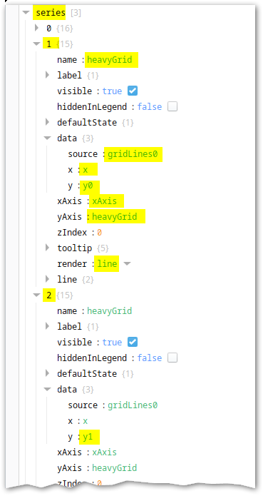

I'm using an XY Chart in Perspective, I wonder if and how could be reach the result of setting a different line width and dashArray of the grid as shown in the attached image
Thank you
Do you want to increase the width of grid?
I would like to increase the width of the grid only on specific rows as shown in the image, this could allowed me to "separate" some items.
You can't modify the grid. But you could add additional straight line plots and set the style as required. For an XY Chart you only need to supply two points for each line - left and right.
You might need to order the plots in the correct sequence so that the "grid" plots are behind the data plots.
I'm not sure I understood correctly—are you saying to add new points in order to create a straight line? In that case, isn't having a configuration like the one in the attached photo a problem? Right now I'm creating horizontal columns serie, so if I were to create two points, wouldn't they start from the hypothetical center of the column instead of overlapping the grid?
Post the formatted chart component JSON for your question and annotate your image so we know exactly what you're trying to achieve. That way we can copy and reproduce your configuration and edit it. Please see Wiki - how to post code on this forum.

          "name": "Rotture",
          "label": {
            "text": ""
          "visible": false,
          "hiddenInLegend": false,
          "defaultState": {
            "visible": true
          "data": {
            "source": "Rotture",
            "x": "toDate",
            "y": "labelYaxis"
          "xAxis": "xAxis",
          "yAxis": "yAxis",
          "zIndex": 0,
          "tooltip": {
            "enabled": true,
            "text": "",

          "name": "heavyGrid",
          "label": {
            "text": ""
          "visible": true,
          "defaultState": {
            "visible": true
          "data": {
            "source": "gridLines0",
            "x": "x",
            "y": "y0"
          "xAxis": "xAxis",
          "yAxis": "heavyGrid",
          "zIndex": 0,
          "label": {
            "text": ""
          "visible": true,
          "defaultState": {
            "visible": true
          "data": {
            "x": "x",
            "y": "y1"
          "xAxis": "xAxis",

        "gridLines0": [
            "y0": -1,
            "y1": -1.75
            "y0": -1,
            "y1": -1.75
    "meta": {
      "name": "XYChart"
    "position": {
      "width": 693,
      "height": 383
    "custom": {},
    "propConfig": {
      "props.dataSources.gridLines0[0].x": {
        "binding": {
          "type": "property",
          "config": {
            "path": "this.props.xAxes[0].date.range.min"
      "props.dataSources.gridLines0[1].x": {
        "binding": {
          "type": "property",
          "config": {
            "path": "this.props.xAxes[0].date.range.max"
... continued due to character count limit ...
Tricks employed:
  1. Create a second y-axis, heavyGrid.
    yAxes.1.render : value
    yAxes.1.value.range.max : 0
    'yAxes.1.value.range.min : -4`
  2. Create new data series with a y-value for each grid line.
    Here I've bound the x values to your xAxes.0.date.range.min and .max.
  3. Create a new series for each gridline. (Create the first, right-click, Duplicate and edit.)
Thanks @Transistor, you're always very helpful.
One question, there's a specific reason why you used number from 0 to -4 and not from 0 to 4 for example?
In the next days I'll try to implement it in the project.
Have a nice day
One question, there's a specific reason why you used number from 0 to -4 ...
Only because T1 is at the top. I thought it might make more sense to have your origin at top left. It doesn't matter but just make it obvious to whoever has to fix or modify it after you!
Sometimes wrong though! Thanks.
