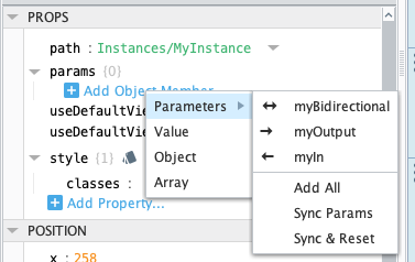

Time for some feedback. As Carl mentioned previously, he’d already been working on a feature which directly relates to this, although it’s not 100% in-line with the requests in this thread.
The feature which is wrapping development works like this:
When the relevant params object of an Embedding component is interacted with by selecting “Add Object member” or clicking the + icon, the context menu where a user would currently select the datatype to add now has an additional slide-over option called “Parameters”. This Parameters slide-over contains two sections: the first section is a list of all of the parameters for the selected View which are NOT currently supplied in this instance, and the second section contains options for adding all of the missing parameters, syncing all parameters to their default values, and syncing all to default values and removing parameters from this instance which are not part of the View’s definition.
Provided a View at Perspective/Views/Instances/MyInstance, with params like this:
Screen Shot 2021-02-13 at 3.27.18PM
A user who then clicks the “Add Object Member” option would expect to see a params option menu like so, where the arrows indicate the “write direction”:
Screen Shot 2021-02-13 at 3.29.44PM
Selecting any of the available parameters adds it to the params object with the default value in place. Selecting “Add All” adds all of the missing parameters with their default values in place. “Sync Params” adds any missing parameters and removes any parameters which are not defined in the View being instanced. “Sync & Reset” adds all missing parameters, removes all extraneous parameters and sets all parameters to their default values, even if those parameters were already in place and had a different value.
So while this feature does not “automatically” update existing instances with new params, it does allow for easily seeing what params might be missing from an instance and it provides a way to synchronize the instance to the “template”.
This feature is still in development and it must still eventually go through QA so it will not make the 8.1.3 release. This is an opportunity to provide feedback on why this might be helpful or unhelpful, or how this might speed development or get in the way.

Excellent. I actually removed “add all” for brevity’s sake - I think “Sync” is going to be the most commonly used option - sync won’t remove any properties that have bindings, change scripts, or are schema-defined.
