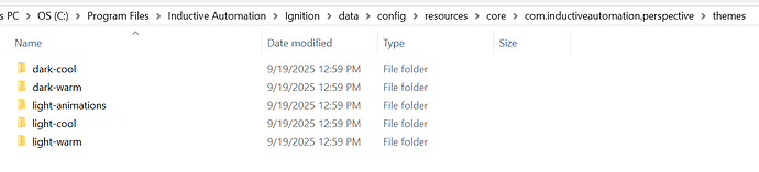

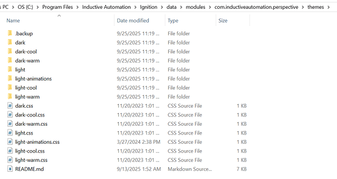

After migrating my project (not in production) to 8.3, my Perspective themes stopped working. The migration added .migrated to my theme folder names. I've tried renaming them back to the original structure and restarted the gateway, but themes still won't load.
Is there a specific migration process for Perspective themes in 8.3? The upgrade guide doesn't mention theming migration.
Before upgrade:
Summary
After:
Summary
I think they should have been migrated to something like $IGNITION/data/config/resources/core/com.inductiveautomation.perspective/config-perspective-(fonts|icons|themes).
Can you at least confirm whether there are resources there or not?

They're there yes. But not all of them looks like it.
Just to clarify, not all resources migrated to the new location. I’ve had common folders and they’re missing along with individual css files that were in the root folder of themes.

@ynejati & @andrew.budaiev I am having the same issues and I feel everyone’s posts are confusing everything. First, @andrew.budaiev is referencing the “migrated” folder from what I believe is the 8.1 themes. Second, @Kevin.Herron is referencing what looks to be a “core” folder that contains themes which is unclear if this is for 8.3.
My question is, what is the correct path for themes that Ignition Perspective 8.3 uses? Please see my images of the different file paths.
The former, data/config/resources/core/com.inductiveautomation.perspective/themes/, is the only path that the system is looking at in 8.3.
data/modules/com.inductiveautomation.perspective/themes was the path in 8.0/8.1.
The "migrated" path that's been mentioned is basically a safety valve - during the 8.1 to 8.3 upgrade process we automatically back up the originals because the migration process is not exactly 1:1. It will only exist if you had any 'legacy' themes to migrate.
