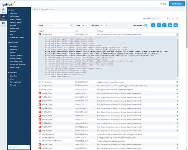

I have a new, few days old, installation of v8.1.10 (and today upgraded to v8.1.11) Ignition gateway in my office for a new project. I’ve never deleted any database connection (I have two: one for PostgreSQL and one for MSSQL), and I have no history tags and nothing in Store&Forward…
And this is my log:
I did not try backup&restore yet…
And it’s strange that no one from IA has commented on this…
That looks like the internal DB, not one of your two connections.
Well, the previous comments suggested that it has something to do with DB connections…
And from these logs, you can’t figure it out…
