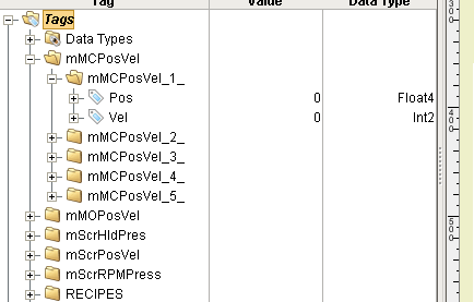

That is a nice solution, Caleb. Unfortunately I wasn’t able to get that to work (or, I was misunderstanding the solution…very possible!:grin:). I’d like to expand on your solution and see if this approach is of assistance to anybody:
  1. In the PLC, build a DUT Structure of the data type(s) that you want in your array – even if it’s only one word.
  2. In the PLC, declare the variable as an array of that structure. Ex.: mMOPosVel:ARRAY [1…5] OF sPosVlcty; Where “sPosVlcty” is the DUT Structure.
  3. That’s it! You’re done. Now you can restart the OPC server (an unfortunate necessary step) and then drag your arrays into Ignition and start reading/writing to them.
It is apparent that Ignition will recognize an array of Codesys DUT’s, but not an array of the actual word variables.
See below pics for reference:
