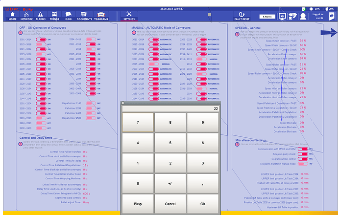

I have a big project in Russia, for what we decided to use windows tablet PC’s for maintenance panels.
All my testing until now was done on ACER ICONIA W700P tablet with intel core i3-2375M (700€), 4 Gb ram, 1920x1080,… I tried Win7, Win8.1, Win10… No problems…
Last week we get the ‘real’ tablets, which will be used in Russia. They are robust, covered with rubber, IP65,… and cost 2500€… and they have intel celeron N2930 cpu, Win7pro 64bit, 4Gb ram, 1920x1200, ssd 64Gb,…
When I first run the Ignition client on new tablet there were some strange ‘lines’ on the screen around my objects (conveyors, pictures, buttons, labels,…).
It took me a while to figure it out what’s causing this. Only on the new tablets, on the ACER ICONIA or on the normal PC’s I never seen this.
If there is a rectangle object on the screen, this ‘strange’ lines appears… Look at the attachements.
This is a setting page where I used transparent rectangles as a frame around settings to logically ‘group’ them together.
I have also made a short videos, where you can see, that lines are actually moving/jumping from one place to another…???

And as far I can figure it out, this is only happening on the rectangle object. And only on this new tablets…

I tried everything, from updating graphics drivers on the tablet, enable/disable Direct3D and DirectDraw in Ignition gateway settings, changing client initial&max memory settings in project settings,… When I remove rectangle objects from the screen, then ‘strange lines’ disappears…

Yes, I found the solution. :smiley:
Change rectangle properties Stroke Style/Join Style to second or third option, then the strange behavior is GONE. Rectangle is displayed normal.

I think there is something in this… Because you can see, that these ‘strange’ lines looks like very skewed parallelograms…
I found also that if you change the rotation angle of the rectangle to 0.1 (or 0.01), then rectangle is also displayed all right (without changing stroke/join style).
