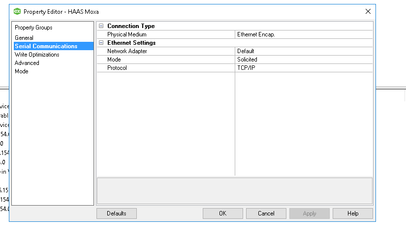

I connected an older Haas VF2-SS to Ignition using Kepware's U-CON driver through a Moxa serial to ethernet device. I've attached the driver setup, it may help you.

Here's the configuration in Kepware and the Moxa.

I think I had to enable a parameter in the Haas console, but I can't recall at the moment.
I am curious how you set up the following. I would be very grateful for any Feeback you can provide! I have been battling this for a while.
Looks pretty good, change Mode to solicited on Haas Moxa, and change Port to 4001, unless you're using port 2 on the moxa.
Thank you ! Another question When creating the tags did you leave the data properties like below?
They are all setup as ASCII strings.
