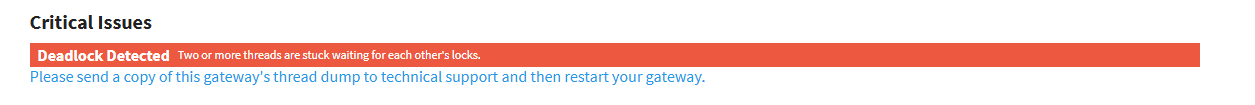

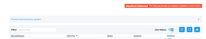

We have put the workaround. Work nice force script update, but when we try to import a project we have a deadlock detected. Any idea what's wrong ?
The work-around is not a complete fix. It only catches the races in one project library script. It cannot deal with races across multiple scripts, and can deadlock in such cases. You'll have to study the thread dump to determine which of your scripts are deadlocking.
(Make sure you do not use python's import statement, in any form, with project library scripts.)
The proper fix is in v8.3.

For my deadlock when I import a project, I change the workaround with a try finally, and it seems to avoid deadly deadlock.

I don't see how that can possibly work. You are instantiating initLock_shared_commun_constantescustom, acquiring initlock, and then releasing (without acquiring) initLock_shared_commun_constantescustom. :man_shrugging:
oops I forgot to change the last name for the example
